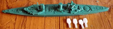

I did find a nice model, although it illustrates a problem if you upscale a model.............
HMS Queen Mary in 1/700 ( lost at Jutland 1916 ). The model was actually scaled at 1/1500 & I scaled it up to 1/700, the hull is just over 300mm long ( I had to split it in two, to fit the build plate ). The hull has scaled nicely - it took over 12 hours to print both parts - but the turrets? Designed to print at 1/1500, the barrels are way overscale! Not a major problem, the turrets look the right size, so some barrel replacements are called for. The FDM printer can't print to the same fineness as a resin printer, but a bit of scratching is good for the soul.................
That looks good Dave. Better looking ship than Hood in my opinion.
