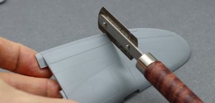

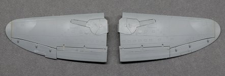

I started on the wings, no separate parts for the flaps or ailerons. It would take some extra time to cut them out and adapt the parts, so for this build I think I’m keeping them as they are… I did use a razor saw to open up the side-lines,
And used a scraper to deepen the recessed hinge-lines, so they look a bit more like seperate parts…

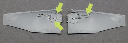

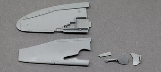

The model will have the gear ‘up’, so I had to adapt the gear parts a bit to close up the underside of the wing.
It was a bit fiddly but I managed to place the panels into the wing. I used some pieces of stretched sprue to increase the glue-contact-area.
Afterwards I cleaned the new panel-lines created by the gear-panels with a scriber.

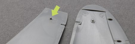

One side of the wing didn’t seem to close properly, so I cut this pin a bit shorter.

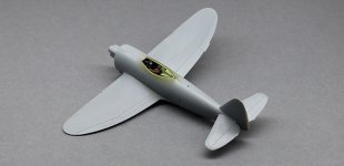

Next I added the wings to the fuselage, no issues and it starts to look like a plane now…

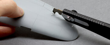

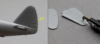

Not much bench-time today, Used the razor saw on the rudder trim tab, deepend the elevator hinge-line…
Also glued the horizontal stabilizers in place…

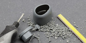

So far the kit is pretty nice, but the one thing I don’t like about it is the engine cowling…

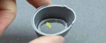

This part is molded in 1 piece, so painting the engine is harder than it should be, but also in order to release the part from the mold there’s an additional inside wall that prevents any pistonheads from being shown.

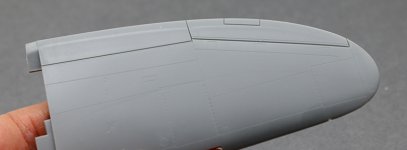

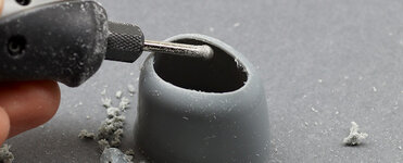

It might be acceptable, but I know it will keep bothering me when looking at the model, so I decided to take out the dremel for a spin…

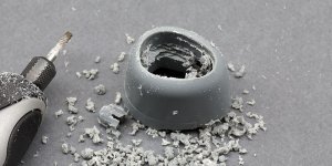

There was quite a bit of plastic that needed to be removed.

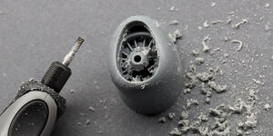

In the end I was left with a solid ‘wall’ still connected to the front,
This was carefully removed with a round dremel bit, not to mess up the contour panels,
After the dremel I used a sanding stick to clean up the fuzzy toolmarks. It was a bit of extra work but I think it will be worth it in the end…

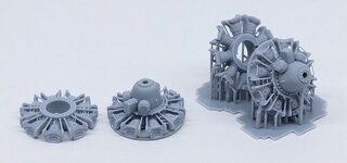

Since I have a 3d printer I decided to make the 3d model myself. To make it accurate I needed a technical drawing of the real thing, but to my surprise that was very hard to find… Eventually I measured the engine from a Tamiya kit (61090) and used a lot of reference pictures of the real engine to make up the 3d model. That took ofcourse a lot more time than I anticipated…

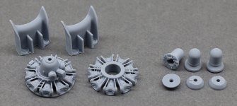

When the 3d model was finally done I could print it, I fitted 2 complete engines (middle), 3 spinners (left) and 2 oil-cooler inlets (right)…
The support-structure was removed, next I cleaned the parts with IPA and UV cured them…
I must admit it’s quite satisfying to look at parts you designed yourself, I’m glad I’m finally using the printer for what I originally intended…

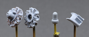

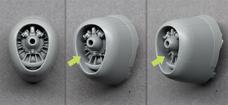

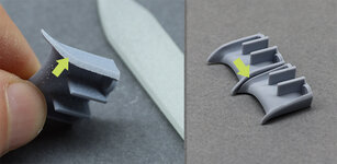

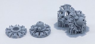

Left: Some smaller support structures needed to be removed. Right: The inlet for the oil-cooler didn’t fit properly, this was a tricky part to design because of the curved engine cowling…
So I had to adjust the part a bit with a file, you can see the adjustment when put next to each other (right).

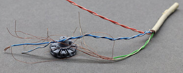

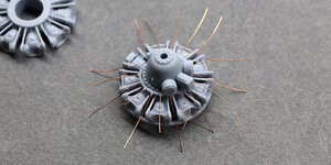

The engine can still be improved with cables, for this I used the copper from an old LAN-cable…
I’ve seen some people here do the same thing and always loved the finished results,
I used superglue to attach the wire, then tried to cut and bend it into shape, which took a while as they broke off easily…

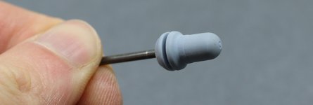

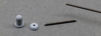

I cut a 2mm steel rod for the shaft,

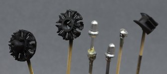

I made the spinner in 2 parts so I can add a transparent disk in between, the idea is that the spinner looks like it’s rotating…

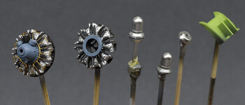

Parts on sticks, ready for the airbrush…
Vallejo ‘black’ primer was used, the spinners got ‘black gloss’ primer and a coat of Vallejo ‘Chrome’ paint…
Yesterday evening I handpainted the details, at the moment I only added the base color. Washes on 3d parts can reveal layer-lines, so I’ll have to try out a bit…
