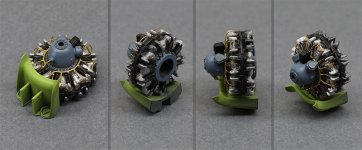

I’ve glued the engine parts and oil cooler together,
The original engine mount was removed with a small hacksaw…

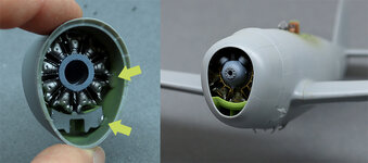

I glued the engine with 2 part epoxy to the cowling, afterwards I added some more glue to the rest of the cylinders. Although I’ve put an effort in making a completely new engine, most of it will be hidden ofcourse… At least it was fun to do!

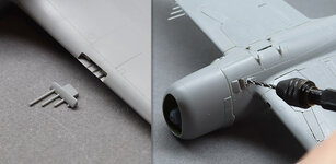

I added the machine-guns to the wings, also drilled out the waste gate of the super charger (the kit shows a closed valve).

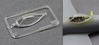

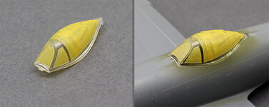

The canopy is molded in 1 piece, it fitted well but the tail-end had some upward tension and didn't stay in place, so I later had to clamp it down.

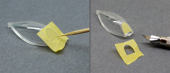

Tamiya tape was used to mask the canopy. I look for the contour with a cocktail stick and make the cut with a small blade.
With the masking done I glued it in place with micro kristal klear,
But as I said before I needed to add a clamp to the backside…

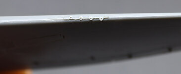

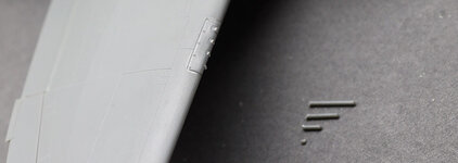

Very last minute I decided to replace the plastic machine-guns with metal rods, so I cut them off,

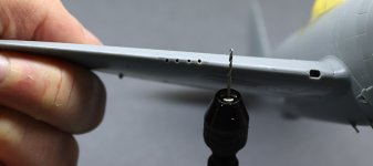

I marked the centers with a pointy tool,
And drilled them out, I hope those guns will line up in the end…

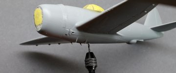

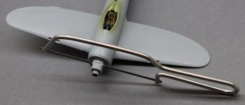

Also drilled a hole in the belly for a 2mm steel rod…
