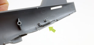

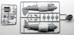

I want to turn this plane into a ‘flying’ model (on a stand), so the hatches for the tailwheel need to be closed. I used a scribing tool to remove the hatches,
and then I glued them back into the fuselage in ‘closed’ position. Added a small piece of sprue for reinforcement.

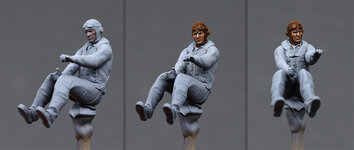

So I bought a copy, scaled it down to 1/48, fused all his parts except his head and then used ‘Chitubox’ to create the supports and printed the model x4 times on an ‘Anycubic D2’. I probably make it sound easy but those with a 3d printer know what a mess and time consuming process it can be…
After cleaning and UV-curing the pilot came out very nice in 1/48,
I kept his head separate so I can glue it in other angles, that way I can make variations and use the same pilot-print for a few airplanes and still keep it interesting…

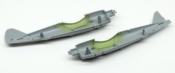

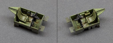

Next I started airbrushing the cockpit interior green, I primed the parts with Vallejo olive drab primer, then mixed the final color with some Vallejo light green and yellow…
That’s all for the moment, next I’ll need to paint the pilot and add the decal for the instrument panel.

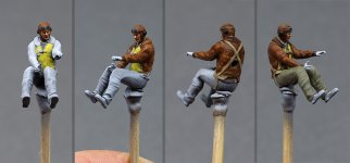

The pilot

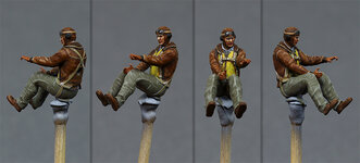

I really like to add figures because they add life and scale to the model, but I always struggle a bit getting started as I don’t paint a lot of them and each time I have to ‘reinvent’ my technique…
The pilot was primed with Vallejo primer (first black, then white from above). I started with a dark skin tone, and added lighter tones on parts of his face as I went. After the face I painted his hat with some brown colors.
Then some yellow for the life-jacket, more brown for his jacket, a few details with black and khaki, green for his pants…
With all the base colors done I try to mix and add some small shading tones (light green for the pants, light brown for the jacket etc…) Also added gloss varnish to the goggles.

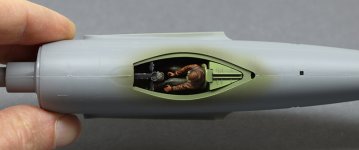

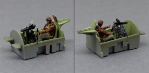

Thanks guys, I had some more bench-time today and glued all the cockpit parts together,Steven_P47D_022.jpg
The pilot was put in his seat with superglue, he fits nicely and holds the stick just below the handle, but acceptable as he’s a bit tired on his way home : D, his left hand is hanging in thin air since the throttle-control is missing in the kit (Perhaps I’ll add that later).

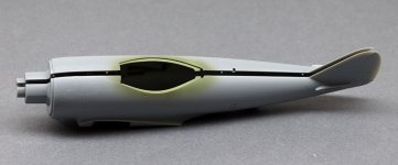

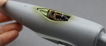

The placement of the cockpit is very easy and well designed,
The model will end up on a stand (flying), so in a later phase I’ll have to drill a hole in the underside. In order to have some ‘solid material’ in that place I’ve added a piece of wood, I drew a center-line on the wood to make sure the block is about 55% inside the first fuselage-halve, that way I’m sure the 2nd halve will fit without hitting the wood. The wood was fitted with a few drops of hot-glue.

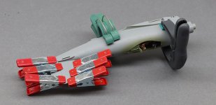

Next I glued the fuselage together with Tamiya Extra Thin and added a few clamps.
At first glance no putty will be needed, still need to scrape down and clean the glue bond.
