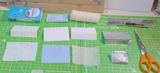

Set up a little experiment too see what works best....
Some strong tissue, bit thicker than standard loo roll.
A small glasses cleaning cloth.
Some old bandage gauze.
Some tinfoil, doubled over and edges folded over to make a crease/hem. (Also holes punched in corners).

Gathered the materials, pva, water, clingfilm, and checked the cut samples all fit the formers....

Each sample (tissue, cleaning cloth and gauze) was then placed onto each former and liberal amounts of thinned pva applied. I used a rough mix of 60% pva to 40% water so it was slightly on the thick, but still liquid side of things. As above the foil does not require pva.

Here's the cleaning cloth and gauze after being coated in pva. I ended up soaking the cloth in the pva solution as just brushing it on was not penetrating the cloth that much, but by soaking it, the pva was absorbed much better.
