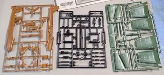

My next victim is a nice old, (not quite sure if its proper "vintage")? but its definitely old Matchbox Ju87 Stuka in 1:72 scale.
NB: This will be my first attempt at using an airbrush on one of my models [Gulp!]
This kit was part of a larger auction lot, which I bought about a year ago, which had about 5 or 6 kits in the lot. So this kit only cost me about £3!
This kit has two versions, (one carrying bombs and one with the large machine guns)......but after now starting the kit, I think that one of sprue may be missing? as some of the alternative parts for the kit appear to be missing! There should be two sets of wing parts, but it looks like there is only one set?
But as this is a guinea pig kit anyway, we will plough on and see what we can do.
There are alos two paint schemes for this kit, see box art, etc, and no, I will not be doing the tinly patterned mottled camo one as my first air brushing paint job, no way, no how, I'm keeping it simple and easy for now....
