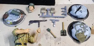

Made a start on painting, small bits were brush paint, but the main body and head were spray painted with the airbrush.
Also started on the head, and the dreaded eyes!, here's where I am, the eyes are not perfect but pretty happy with them TBH.
Bit more progress, started on the pea pattern camo scheme.
Was not sure about the original airbrushed base colour, a light sandy brown? but I mulled over it for a while , and as its seems to be hard to pin down an exact color scheme, I decided to just go for it. Whats the worst that can happen!
Added a dark green dot pattern first, I wanted the dots to be quite small, so I have used a micro brush (Albion Alloys), which seemed to work ok.
I then added a dark brown dot pattern and finally I added a very light / pale green dot pattern.
Paints used below, eg: XF26, XF10 and XF21.
I have also now painted up all the figures accessories, eg: grenade, bread bag, gas mask cannister, bayonet, MG, ammo pouches, belt buckle, water bottle, etc and highlighted a few small details. The head now has its helmet fitted. These will all be weathered up a bit later....
The camo pattern is still a bit loud/bright IMHO, but I will tone it down a bit with weathering, etc.
I have only put a light mist coat of flesh tone on the arms, they will need at least another coat, maybe two.
