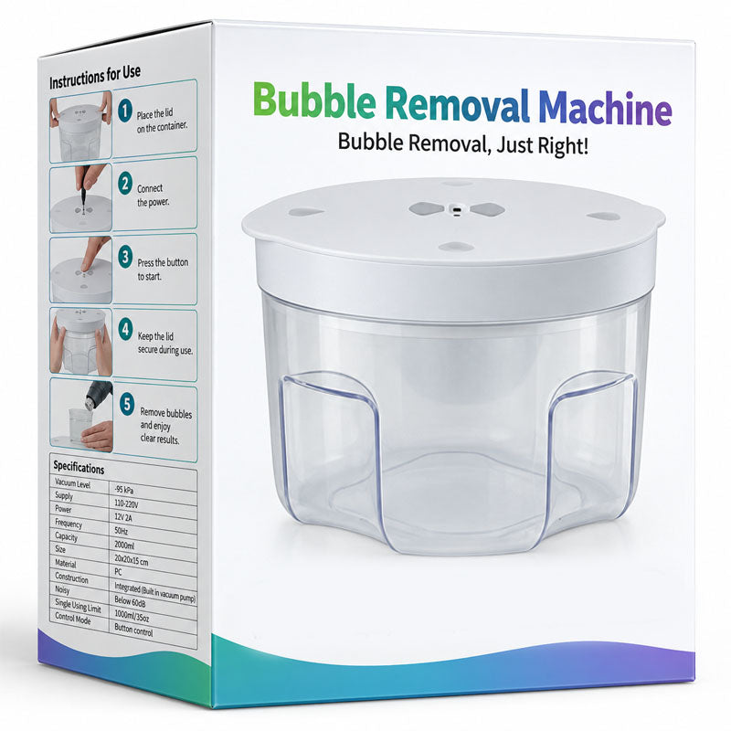

Put a cup of resin in one of these for 10 mins, it will remove all the bubbles and come out crystal clear.
