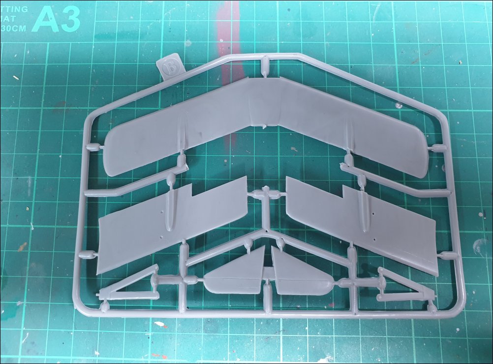

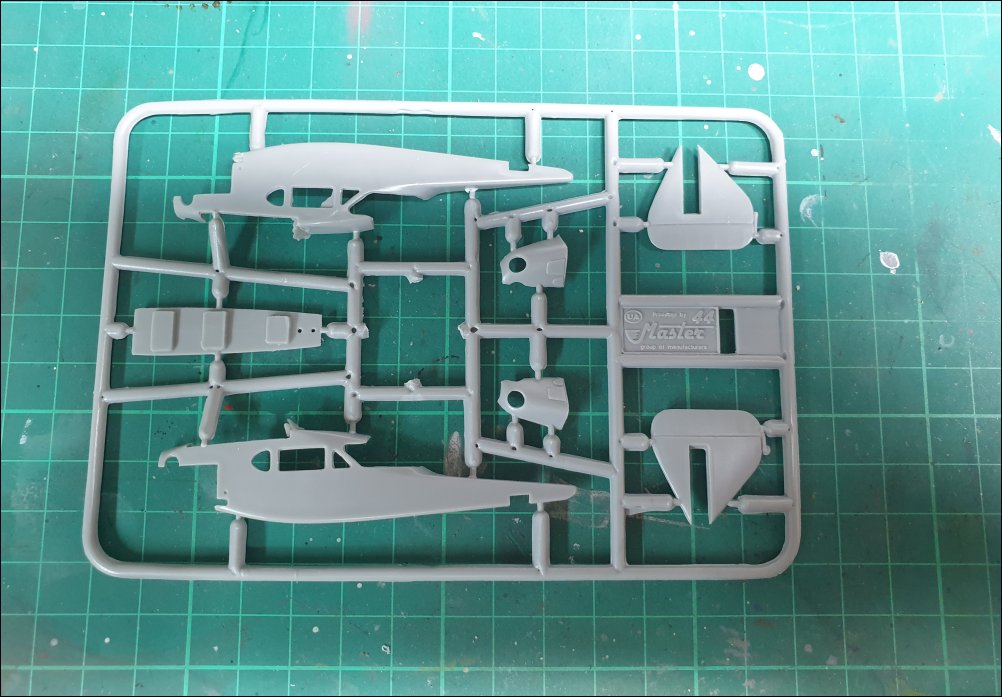

The parts are moulded in a grey, softish plastic with a lot of flash and seams to clean up. Runner A:

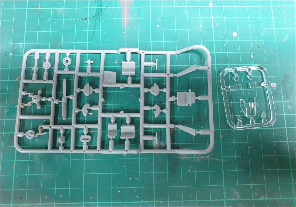

Runner C & Transparencies:

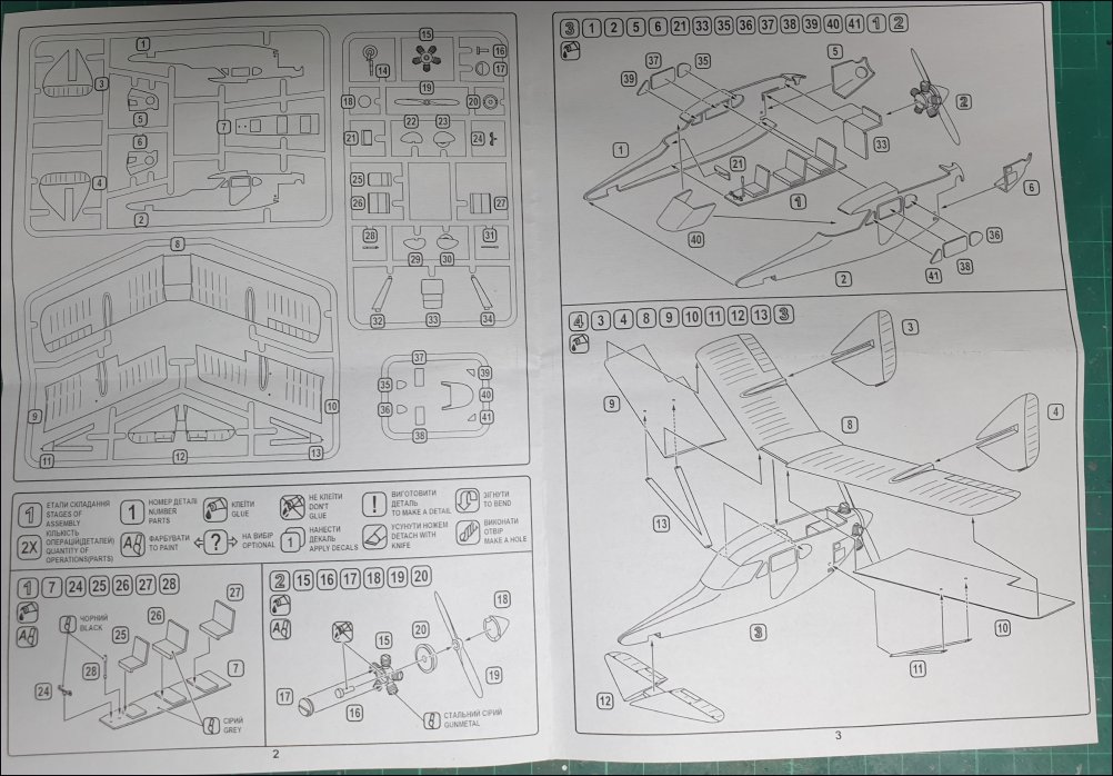

Instruction Leaflet Pages 2 & 3 - Layout of Runners - Assembly Sections 1 to 4:
Instruction Leaflet Pages 4 & 1 - Assembly Sections 5 to 6 and Painting Profile - Copy of Artwork and Potted History of the MiG-8:

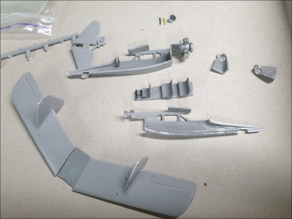

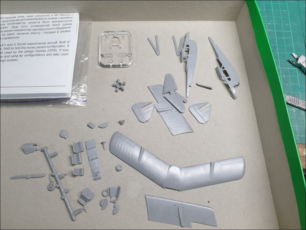

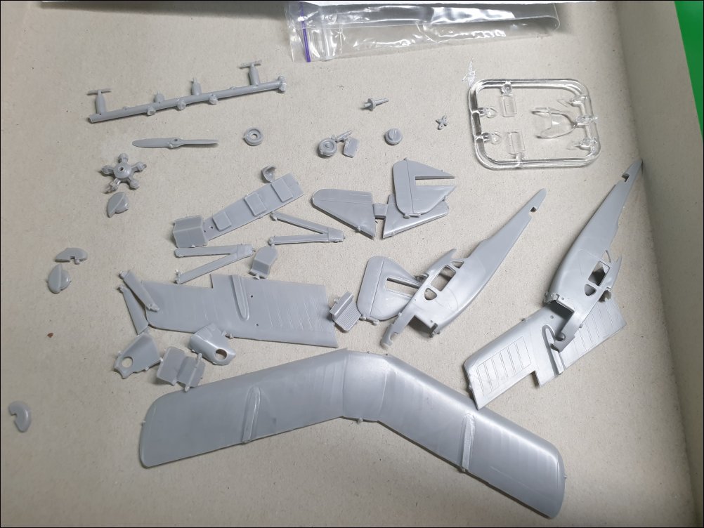

First thing was to remove the parts from the runners:
Then they were cleaned them up, a process that took a couple of hours:

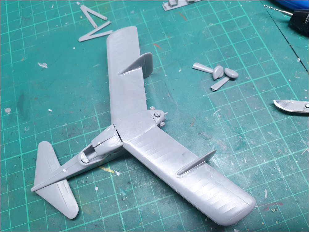

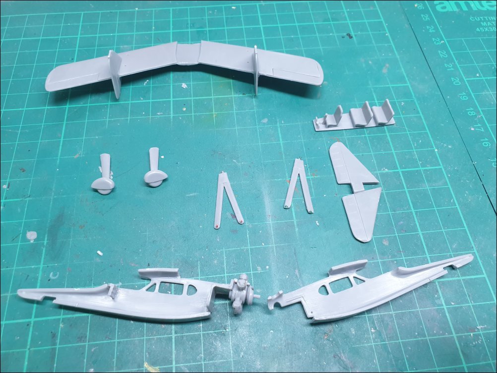

It was then time to begin assembly. Despite having cleaned up the parts, a lot of fettling is necessary:

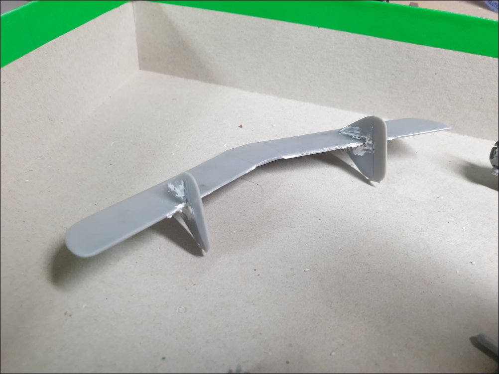

The wings need a lot of filling where the fins join the wings and the trailing edges are rather thick and will need some sanding. The wing struts are handed so I marked them with the appropriate red or green ink. Some of the wing locating pins for those were much too long and needed shortening, while the fuselage locating holes for the struts needed drilling out:
A view from the underside. The locating slot for the canards was too narrow and not deep enough so a quick going over with a scalpel sorted that out. As you can see, the port-side wing struts are too short so I may have to drill new locating holes on the wing:
A view from above which shows a large gap where the front of the wing fits the fuselage. However, as the fuselage halves haven't been glued together yet, that gap may well reduce:

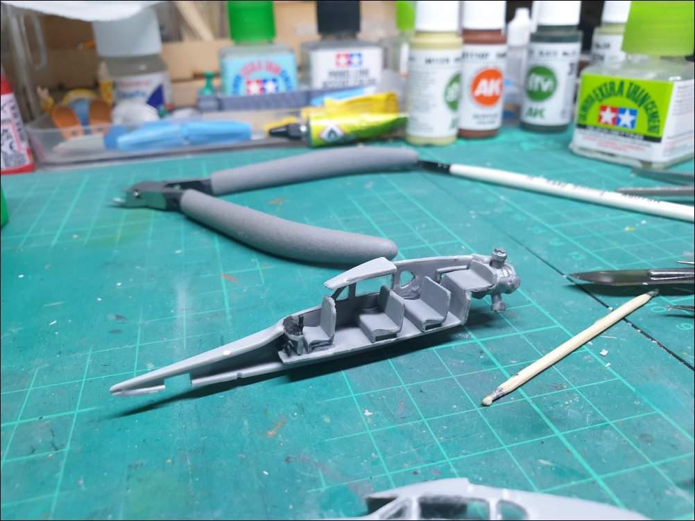

I gave the interior a coat of H140 Matt Gull Grey:
I put the windows into place, but was very difficult to get them into the frame. Once in, I ran some extra thin poly cement around the edges of the windows:
The cockpit floor was glued into place:

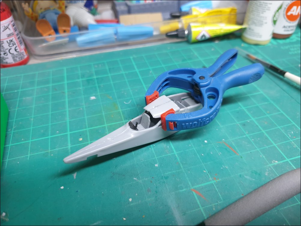

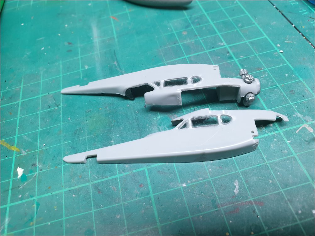

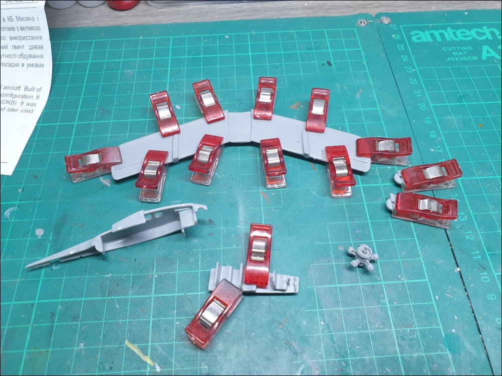

The fuselage halves were glued and clamped:

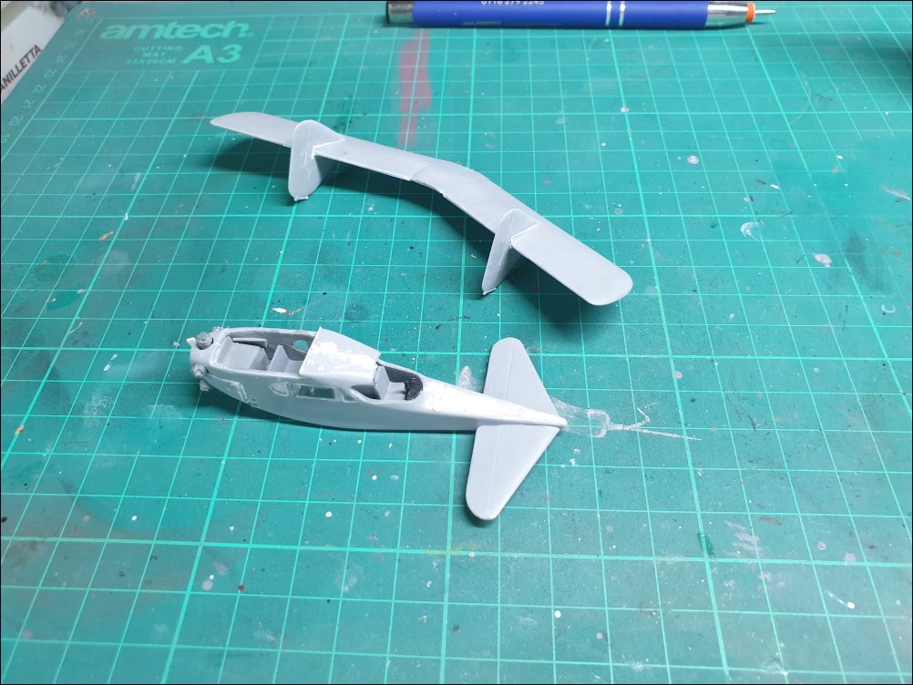

The trailing edges of the wings were sanded and filler applied to them and to the fin joins:
The rear engine covers were glued to the fuselage as were the canards:

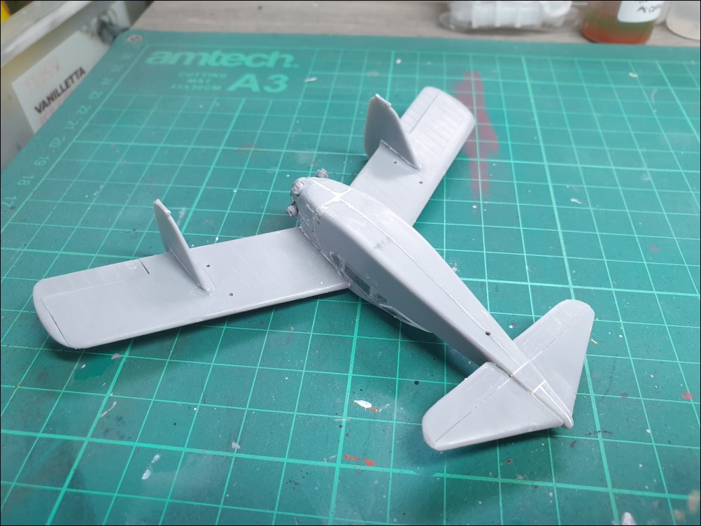

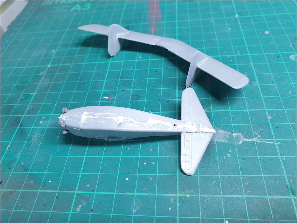

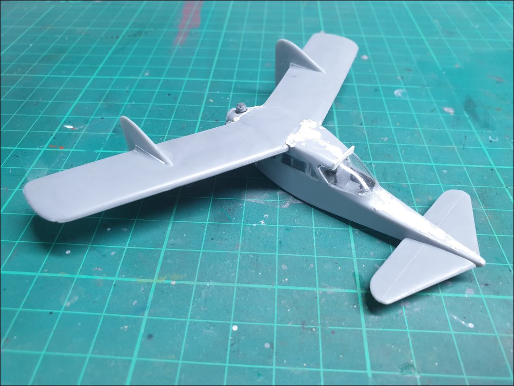

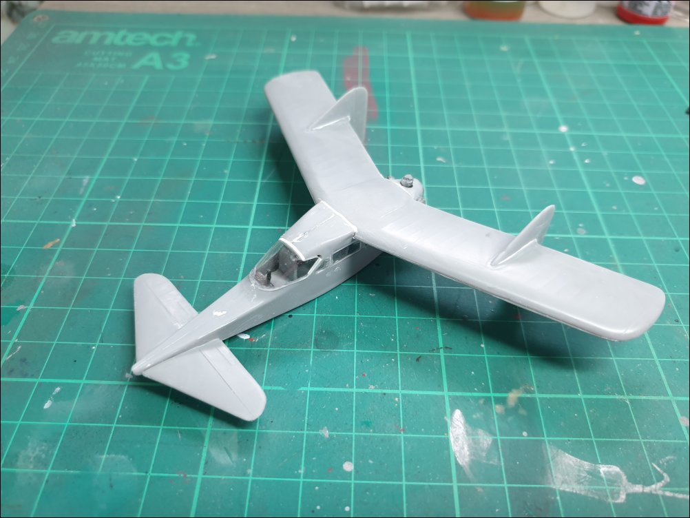

Another update. I have managed to clean up the filler on the wings but the fuselage is taking longer as I have used plastic card to fill some of the gaps:
The underside showing more filler:
I have added more plastic card each side of the fuselage/wing joins and in a couple of gaps where the canopy meets the fuselage:

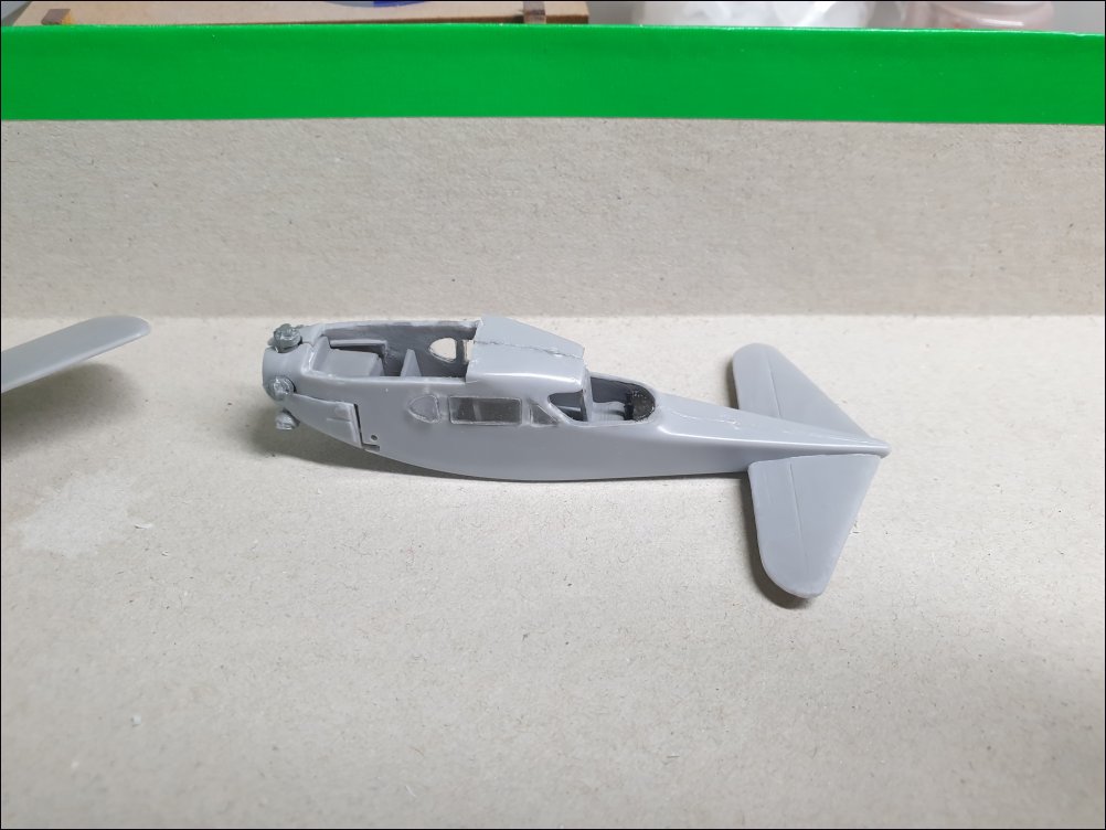

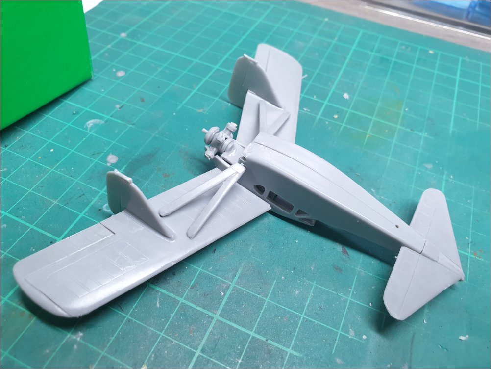

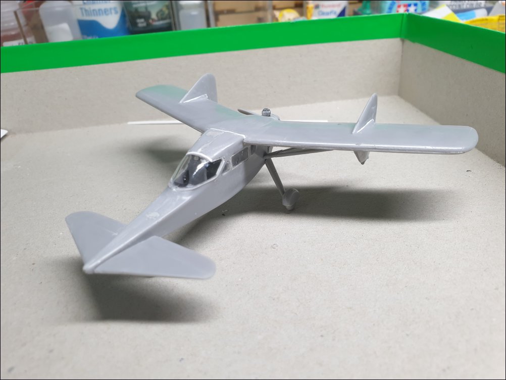

It has been almost a week since my last post but I have made progress.

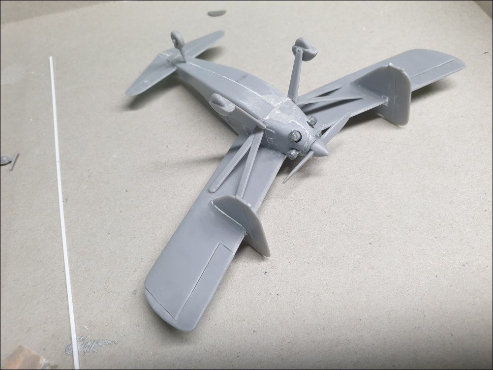

I spent a lot of time sanding the side windows flush with the fuselage. Once done, I glued the wing stays, undercarriage and propeller:
View of the underside:
