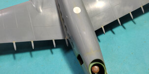

More progress...
Click image for larger version  Name:	1000174176.jpg Views:	0 Size:	285.2 KB ID:	1273937
This time its putty filling. I use Magic Sculpt two part putty for this process.
Click image for larger version  Name:	1000174178.jpg Views:	0 Size:	279.9 KB ID:	1273938 Click image for larger version  Name:	1000174177.jpg Views:	0 Size:	306.3 KB ID:	1273942 Click image for larger version  Name:	1000174177.jpg Views:	0 Size:	306.3 KB ID:	1273942
This putty helps with huge steps filling for misaligned fuselage halves. Doesn't shrink either.
Next up is sanding so I left it to cure within the hour.

Happy new year Wabble. Nice work, a question if I may what filler do you use?
Happy New Year to you too Paul, I use Magic Sculpt which is not the usual plastic putty that everyone uses because I hate the shrinkage that happens and will need constant application and sanding. Two part putty like Magic Sculpt doesn't shrink and smoothens with water. Latest trick is using TET with a soft brush to blend the edges... compliments of Calvin Tan. Works best on figure joints...for planes I prefer sanding.
