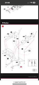

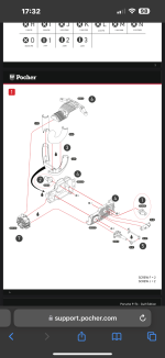

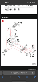

Click image for larger version  Name:	IMG_2735.png Views:	0 Size:	346.3 KB ID:	1245481 Click image for larger version  Name:	IMG_2739.jpg Views:	0 Size:	290.5 KB ID:	1245485 Click image for larger version  Name:	IMG_2739.jpg Views:	0 Size:	290.5 KB ID:	1245485 Click image for larger version  Name:	IMG_2739.jpg Views:	0 Size:	290.5 KB ID:	1245485 Click image for larger version  Name:	IMG_2761.jpg Views:	0 Size:	256.5 KB ID:	1245486 Stage 1 Construction of the drivetrain and some sort of vent pipes fairly simple nine or 10 pieces put together with glue (Note about glue or cement Tamiya Extra Thin will stick some of the plastic but it’s mostly CA cement as a majority of the non bolt or screw together parts are either ABS or metal) and nuts and bolts or screws in this case as you can see when I first put it together there was large gaps and seam lines in the pipes so this necessitated them being sanded then filled Using Vallejo plastic putty. This was then smoothed down primed refilled sanded re-primed then a final coat was added it’s not quite the correct colour they started as but it’s close enough and it looks a lot better than without the seam lines down the side.
Where possible I am going to build this out of the box but there will be slight modifications required such as in the one with the pipes because you can’t have seam lines like that just looks awful I’ve also included braided hoses as the ones supplied are smooth and I don’t know about you but any car I’ve looked at any sort of hose is braided. It’s not smooth other than some radiator hoses they may be smooth. Similarly with the spark plug leads. I’m going to change the ones they’ve supplied as the ones supplied are floppy and will not lay where you need them to go so I’m gonna use solid wire with a plastic Red sheath on it to represent the spark plug leads

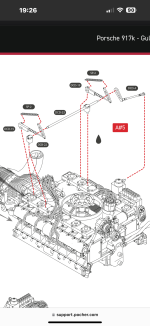

When I last left you we were just coming up for the end of stage two and starting stage three or stage three is a long process at least three separate sections to it. I’ve now completed two of them first off. I’ve added the, I’m not sure what Nigel called them I think they are throttle covers or something like that and as supplied by the kit they were just plain gun metal well I’ve done what Nigel did and painted them because I think they look a lot better.

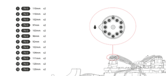

I also painted the fan drive pulley and replace the plastic black tubing with fibreglass woven sleeve which looks a lot more realistic, especially after it’s been painted and the final section I’ve done was the distributors that was a pain the tubing they’ve supplied is utterly useless so I’ve done what Nigel did. I’ve got some single stranded copper wire with a red PVC coating on it and use that instead this is a long drawn out process. you had to get each length of wire the same as the instructions and then find out that the instructions are wrong and they need to be longer so I’ve added 10mm to each of my lengths Click image for larger version  Name:	IMG_2850.png Views:	0 Size:	411.2 KB ID:	1246248 hopefully that will suffice. The next stage will be fitting the distributors onto the engine along with the throttle linkage system and the exhaust pipes and that should finish the engine.

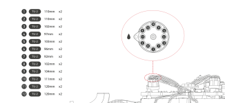

Click image for larger version  Name:	IMG_2883.jpg Views:	0 Size:	336.2 KB ID:	1246550 Just added the distributors and the exhaust pipes to the engine now waiting for it to dry thoroughly whilst I get the diagrams to the spark plug leads sorted

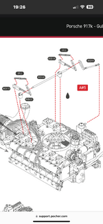

as I stated earlier I’m not using the supplied tubes as they are in my opinion and Nigel’s useless so I’m doing the same as Nige and using GPO phone cable .7mm
This has two advantages one is the correct scale and two as it’s a wire and not a tube it will stay where you bend it. You’ve had to add little rubber tubes to the side of the engine for the plug-in too but other than that I think it’s a better option. I can’t do what Nigel did which is a drill out the top of the distributor so that the cables could push through and I had a disaster with that so all my leads I’ve superglued the tops of each pin and use the superglue as the plug cap basically then painted it black to resemble the rubber cap hopefully they’ll stay on if they don’t we’ll have to glue them on again
Click image for larger version  Name:	IMG_2920.jpg Views:	0 Size:	257.7 KB ID:	1246668 Click image for larger version  Name:	IMG_2921.jpg Views:	0 Size:	299.9 KB ID:	1246669 Click image for larger version  Name:	IMG_2922.jpg Views:	0 Size:	277.5 KB ID:	1246670 Click image for larger version  Name:	IMG_2923.jpg Views:	0 Size:	269.9 KB ID:	1246671 Finally finished attaching the spark plug leads to the engine after several attempts not much to say really the pictures will show you more than what I can say other than that it was an absolute PIA to do but we got there in the end For those are interested the cable ties or tape for one of the better word was done with heat shrink tubing and a heat gun which I copied from Nigel from his website as I thought that was a really good idea
