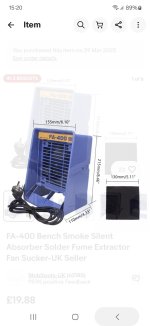

Thanks all for the info, i do have two booths joined in the garage but it's a pain getting stuff from upstairs then down the garden steps, then usually forget something lol.
so got this from evilbay
Too add, it will be easy to fit anywhere on the bench, then simply put away, where as a normal booth will take up a lot of space. Hopefully when we buy our bungalow my modelling room will have the space to add a new bench for the booths. So simple case of turning around!
