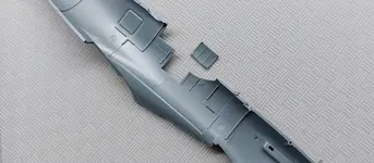

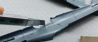

I’m building the model ‘in flight’, so for a ‘closed’ canopy you need to remove a small portion of the right fuselage.
For the hatch I then need to use part ‘P55’.

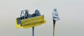

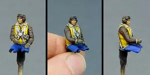

I 3d printed a pilot in 1/48 but he sat to high on the seat, so I had to cut his legs and bottom… To make sure he fits I did a dryfit with the canopy.

I can't tell you how many times I checked the instructions before cutting the same section out for the canopy 😂
Looking good. Pilot fits well after his surgery. Nice to see that you're making an "in flight" model.
Nice one steven , pilot looks great ( despite his surgery! )

I finished the pilot with Vallejo paint, used pictures from drawings and reenactors as a guide,
He was then glued into his office with super glue, the backside was painted aluminium (according to instructions), but pictures of restored aircraft tend to show the whole area in grey-green. I painted the instrument panel as I like to avoid decals if I can. The whole gun-sight is made up of 2 clear parts.

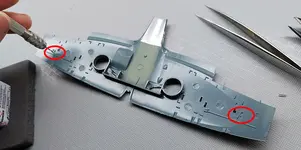

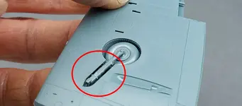

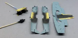

I glued the parts for the wheel bay in place, also need to drill 4 small holes in the lower wing,

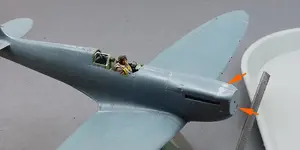

I'm building the Spitfire 'in flight' so it will have the gear 'up' - so far all the kits I've build were not designed for a retracted gear which is a real pain... A quick dry-fit shows the strut on the same level as the wing surface, so that will needs some adjustment later.

The pilot is so well painted I had to make sure it really is 1/48. I’m looking forward to seeing it in-flight, planning on doing the same.
Splendid work. Seeing your pilot, I'm glad I didn't bother having a go at mine !

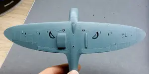

Most of the parts are now glued together, I had the same wing-root-gap-issue like Andy. Took a bit more filler then expected.
Overall the kit has nice detail but some bits feel a bit over-complicated as they like to use the same sprues for different variants.
I'm still working on the gear in 'up' position, on the left is the adapted wheel to fit inside the wheel-bay - on the right the normal wheel.

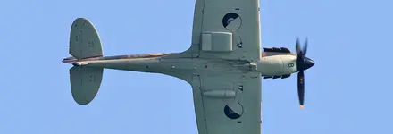

Finished the landing gear today, used this reference picture as a guide,

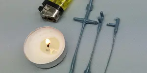

made a few stretched-sprues with the kit plastic to get the correct diameter,
The wheels were sanded with a dremel so they fit inside the wheel-bay, took some trial and error but got them in. The wheels were then glued with a 'gel' super glue. Next I cut the stretched sprue bits into short strands and made those 'T shaped' hinge-things. A bit rudimentary but I think it does the job.
