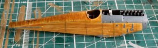

AK3 Dark Sand base coat, then panel definitions added with pencil. Gloss varnish to seal all in, so mistakes can be easily wiped off. Then streaks of thinned Vallejo Natural Wood, then New Wood added, with a small brush - it took me a few attempts, wiping all off & starting again - then sealed in with a gloss varnish tinted with orange
Apologies for jumping in with my process, it just takes a bit of time. I didn't use retarder, the model is small enough for the paint not to dry when adding streaks.
I admit it was an experiment, as I didn't have any oils ( I tried several methods on my guinea pig P-51 before comitting to the real thing ).
The model is actually the Revell reboxing of the Eduard model, that I got at a bargain price ( surprise, surprise ) - I did look at wood decals, but that would hve tripled the total price of the model
