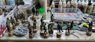

Yup, I wouldn't be able to finish my factory of 25 figures for my diorama if it wasn't for the trusty old airbrush.
Base shadows and highlights achieved... now only the details left for the hairy stick like the face, weapons and webbing.
