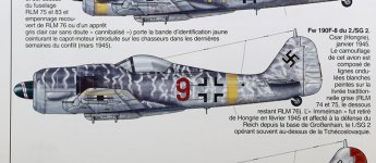

Although the kit offers no less than 5 paint schemes, my eye fell on this scheme from the book “Planes & Pilots, Fw190 1939-1945, p54” (French version)...
Which seems to be based on this Fw190F-8,

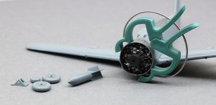

Sprue shots...
I can use the "9" for the scheme from the book,

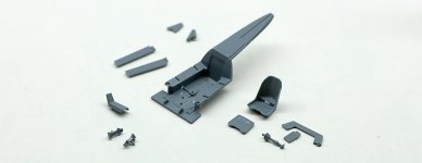

Made a start on this, some parts for the cockpit...
I'm used to work on less advanced/cheap models, so I'm quite impressed with the kit, many options to build as you like.

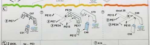

For example the instrument panel can be made from :
- molded gauges (green)
- colored PE gauges (yellow)
- flat panels with decals (red)
I will try the colored PE parts for a change, as I always had molded gauges on my builds.

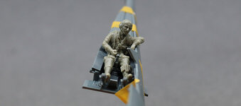

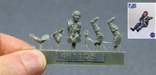

Still had a German resin pilot (PJ productions) in the stash for one of my Bf109's,
I think he will suit well for this project, looking at the crew standing on the wing.
Cleaned and glued him up with superglue, he sits a bit angled to make the arm work on the fuselage,

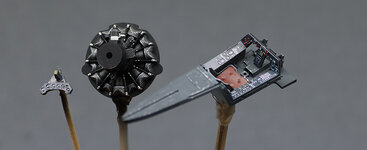

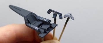

The kit came with nice colored PE parts,
I used superglue to glue the PE in place,
Added some weathering/scratches, the engine was drybrushed with vallejo aluminium, then I repainted the black parts.

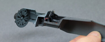

Then all these parts need the go into the fuselage...
Gluing/aligning all the parts at the same time to get the 2nd part of the fuselage on was a bit akward but it worked...

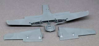

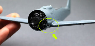

Next I prepared the wing-parts, here I noticed a warp in the bottom-wing (the bottom engine cowling was not level in relation to the wing)
Fuselage ready to mount to the wing,
Here I got into trouble, the bottomwing is warped, and it takes a lot of force to force it into position...
So I 'over-pre-bended' the plastic and then added a strong clamp to get the panel in place, but now the gluebond on the other side has opened up because of the tension...
Also glued the bomb included in the kit, the kit is an A8 (fighter), but I'm building it as an F8 (ground attack) from the B&w photo...
So that's a very weird issue, does anyone else had a warped bottom wing? (Sprue "82140 I") Perhaps my kit had trouble comming off the injection machine?
