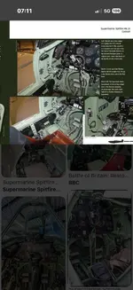

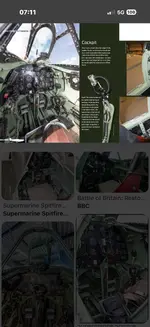

After finding a couple of good reference images online Ive added a bit more to the cockpit. Its now a mix of kit parts ( basic but usable) the Eduard etch and 3d decals and a few scratchbuilt bits . There's a few more decals to add and it all needs further painting and a wash but its getting there . This kit is certainly living up to its questionable reputation , the control column having a spurious square grip - no spit ever had a grip like this so it was cut off and a round one made .
